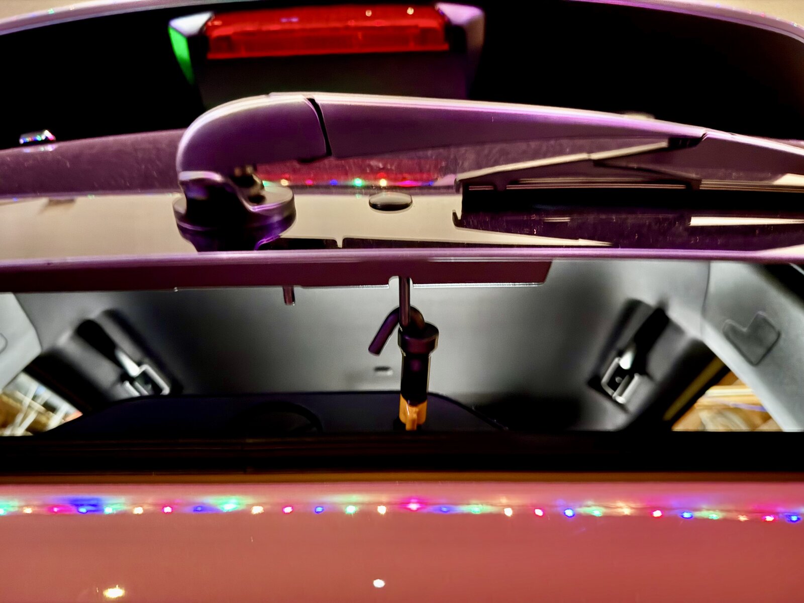

I use one of these (different brand) to keep my FJ's rear window cracked open but lockable (so it doesn't complain if I drive). I haven't checked if it works on the Land Cruiser yet, I can do that tomorrow.
Ventlock Tailgate Lock
Those look pretty useful. Seems easy enough to make....... Might just have to fab one up.
Thanks for the idea!
You can also use appropriately sized D ring swivel clips if you don't care about it being lockable. And rattling a lot.
