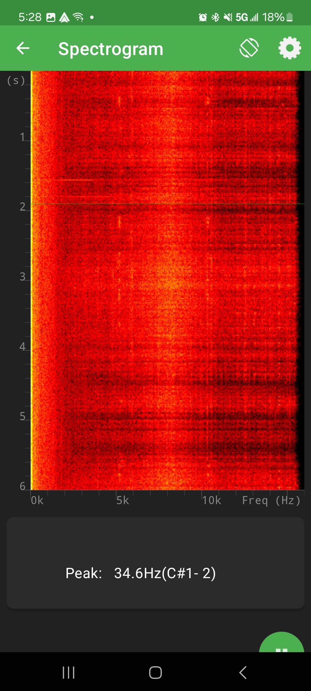

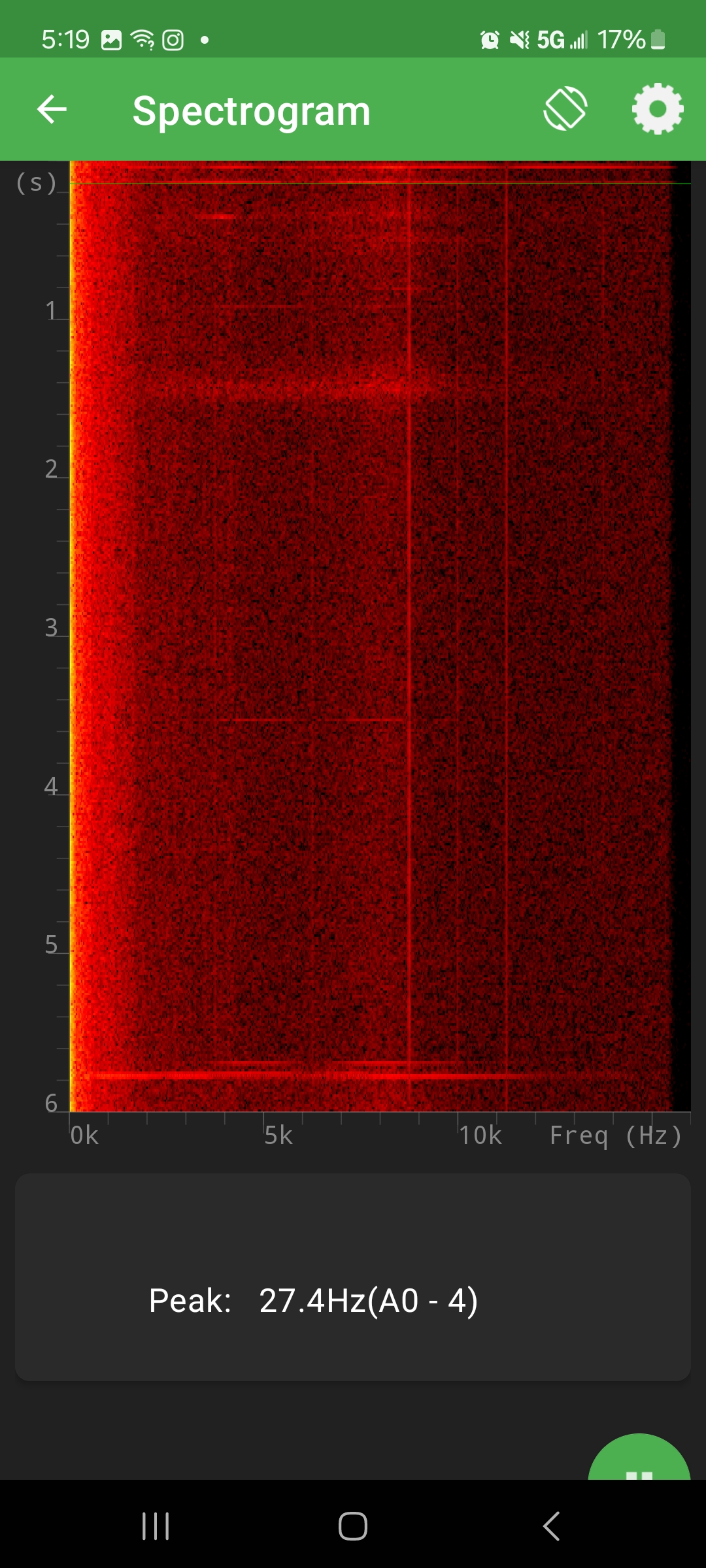

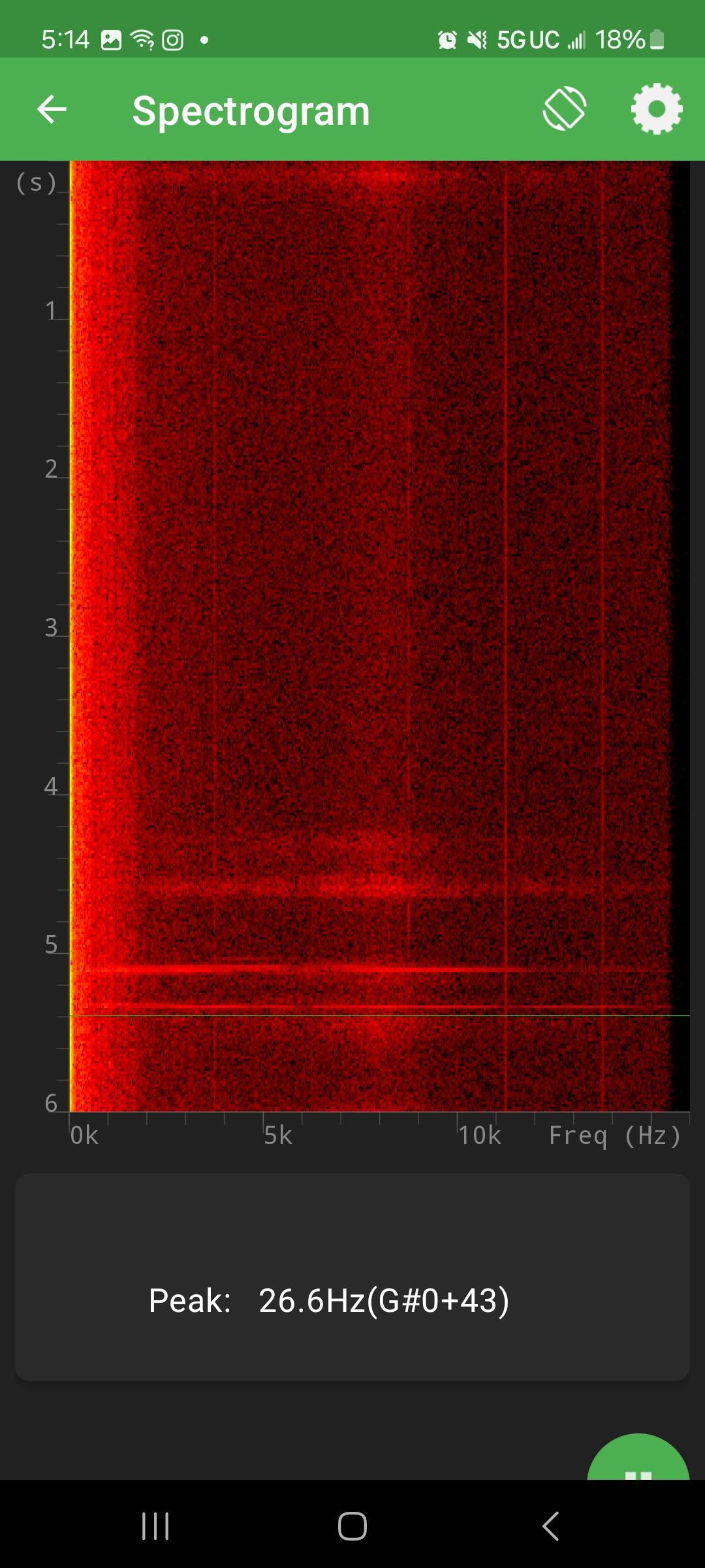

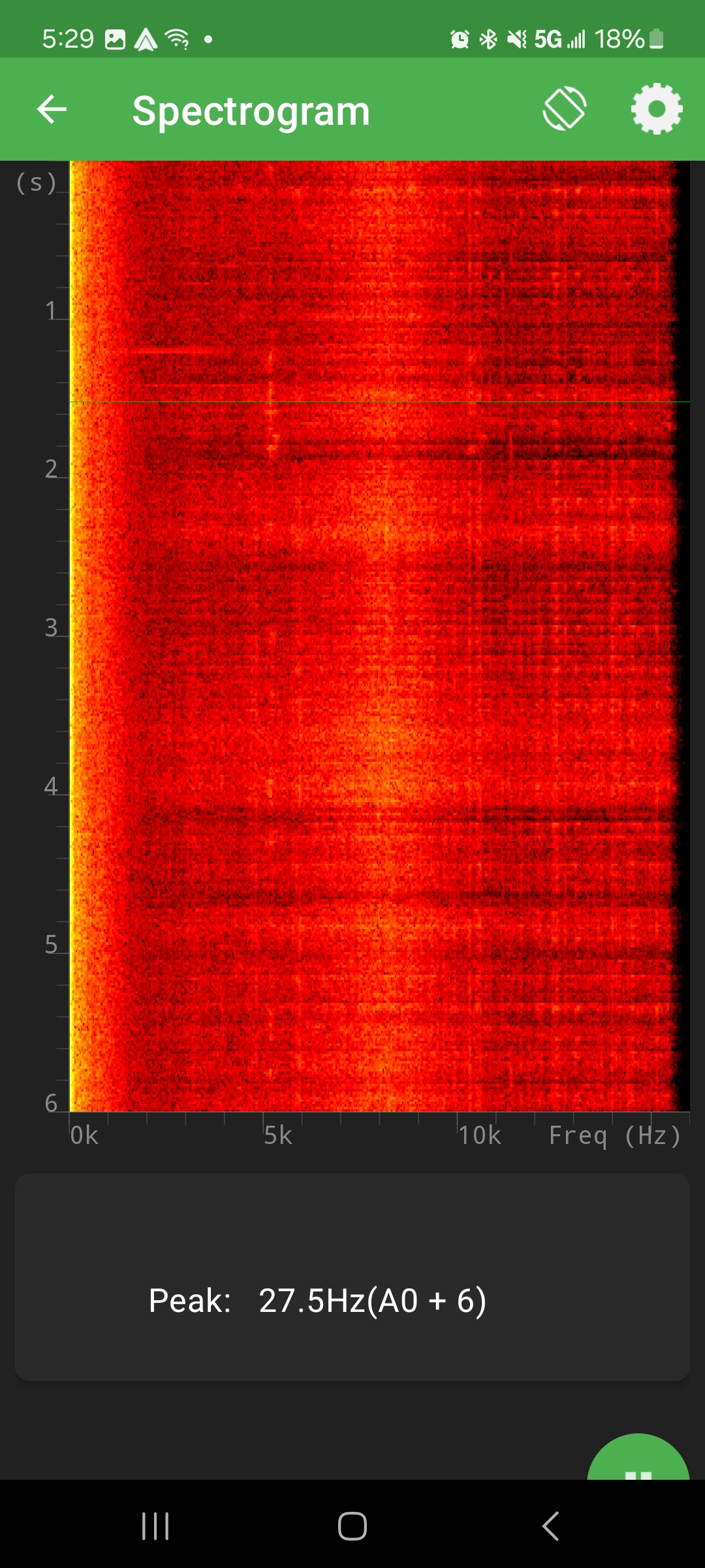

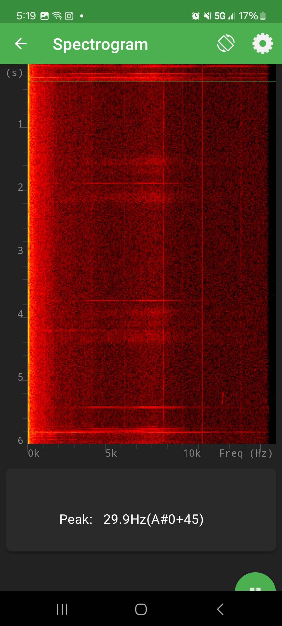

So I took a few spectrograms
These are with the vehicle stopped. You can clearly see a few very distinct frequencies between 8 and 14kHz. They are so narrow that they can't be of mechanical origin (like gear noise). They appear and disappear randomly. Some go away, while other show up.
These are with the vehicle moving. If you look closely, there is two frequencies, one around 10 and the other around 13kHz that seam pretty persistent.
All these noises are very faint, and me being over 60 years old, I can't hear them. But somebody with very sensitive hearing may.
As for origin, because they are so narrow and steady, they appear to be of electronic origin. DC to DC converters and frequency inverters usually operate around 20kHz. So this noise may come from the power inverter, but also the infotainment system or even USB chargers.
