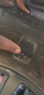

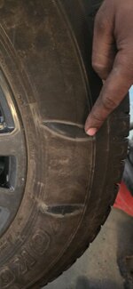

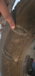

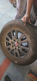

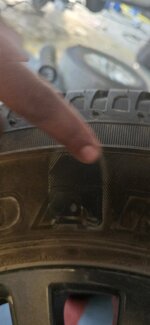

I have submitted a request to the Toyota service and they are working with the factory to fix it. My spare tyre was over tightened in the factory resulting in a damaged wheel (indents you can put your finger in). For now I am playing around with Carista app that resets the error.
