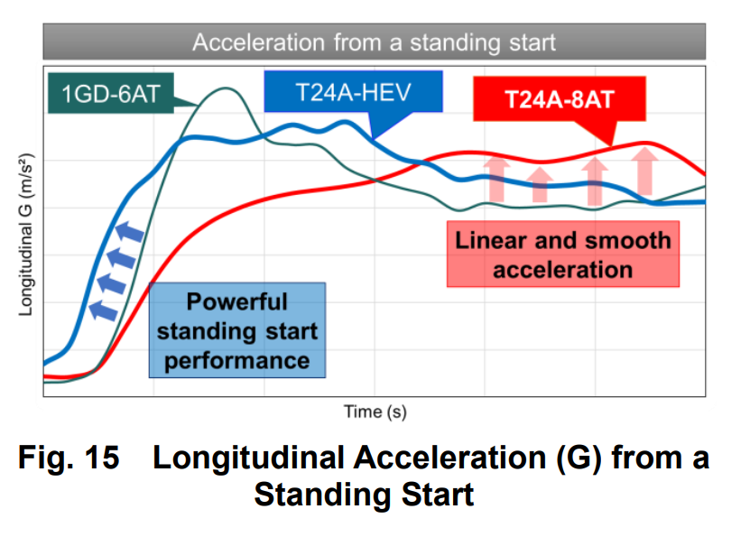

There is an interesting figure comparing acceleration for the various powertrains:
This seems to show the non-hybrid T24A overtaking the hybrid at a certain point, perhaps due to the added mass of the hybrid system. This could explain why we see slightly quicker 0-60 times for the non-hybrid 4Runner.

This is not overtaking, y-axis shows acceleration rate. It won’t be able to overtake since hybrid configuration has much higher acceleration rate early on. In other words, If we calculate average acceleration rate, it would be higher for HEV.

Here's a nice video showing how the rate of acceleration is related to the time it takes to travel a given distance. Not mentioned in the video is that the velocity of every ball will be the same at the end point.

I just meant overtaken in the Y-axis of that graph.
