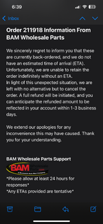

For anyone who still has the trim but broken or lost yellow fastener, since the dealerships have this simple plastic piece (and any other LC parts) on back order for months, I believe this amazon solution should work: Amazon.com
One of these two should be a suitable replacement. I discovered that it should be placed into the trim first, not the hood body. It snaps out of the body from the back with pliers to compress the prongs.
