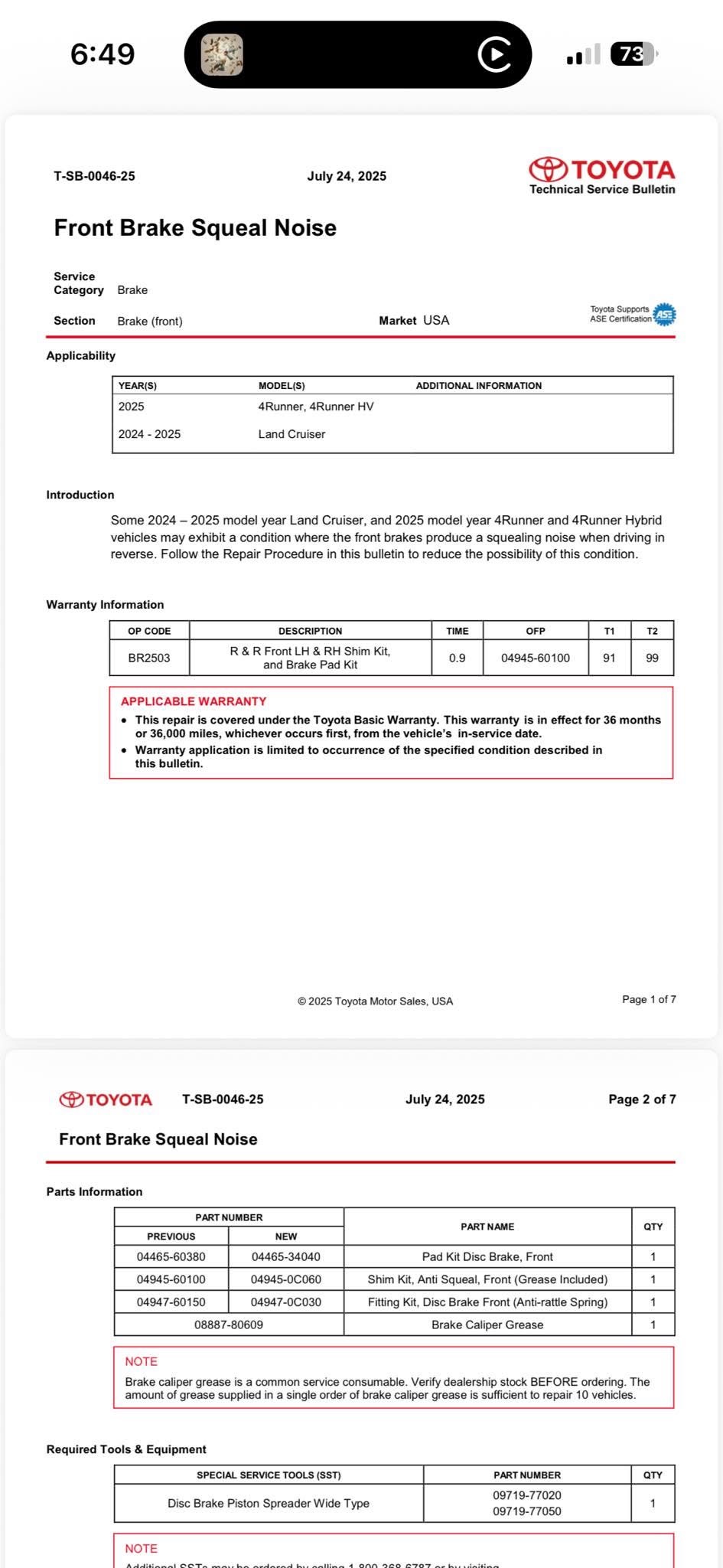

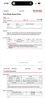

someone put it here already!
Here’s the photo of the doc.

It’s same parts as the Tundra TSB, minus rotors, parts had them on hand from folks that had sold their Tundra or had not answered calls to get it fixed.
Here is the full PDF. I find it very interesting that we have to wait for a TSB to be issued and also the amount of time it took compared to GX550 TSB that has been out for a while. I guess the days are gone where we can just take our vehicle under warranty to a dealer and they will fix an issue without a TSB. This really proves most service departments are just profit centers and they really don't care, unless there is TSB. They could have attempted to fix this issue without a TSB, the TSB guarantees they get paid for the repair. Many owners have been dealing with this issue for over 1 year, with dealers refusing to fix it.
Also please note the GX550 TSB includes the disk rotors... the LC250 TSB does not... lets hope the rotors are not needed.

I'm thinking the dealership will verify that your brakes are squealing in reverse before they would replace them.
You are in agreement with the TSB :)
I have a slight hint of brake noise in reverse. From what I have read in threads here on the forum, this will get more noticeable over time.

I would be interested to know what materials Toyota uses in their OEM pads and if the parts in the TSB have different composition to what was fitted off the assembly line should anyone know and want to share. As long as braking performance remains good, I am inclined to leave well enough alone for now unless that slight brake noise gets significantly louder before seeking out dealership work under that TSB.
Yep.
First step in the Repair Procedure is to confirm the condition exists, and if not to diagnose per the repair manual.
Mine wouldn't do it at the dealer last time since it tends to be a first thing in the morning event. Best to take along a video.
