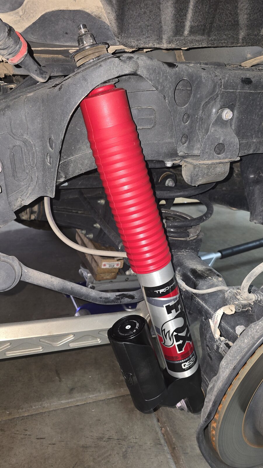

Looks great. You don’t need upper arms if the shock lengths are the same . The extra top spacer with total .6 inches of lift (2:3 motion ratio) isn’t enough to cause interference between the uca and the springs . You can try that by putting the front suspension at full droop. You most likely need to change your bump stops however as with the spacers they are no longer in play and that doesn’t include differences in shock length and travel

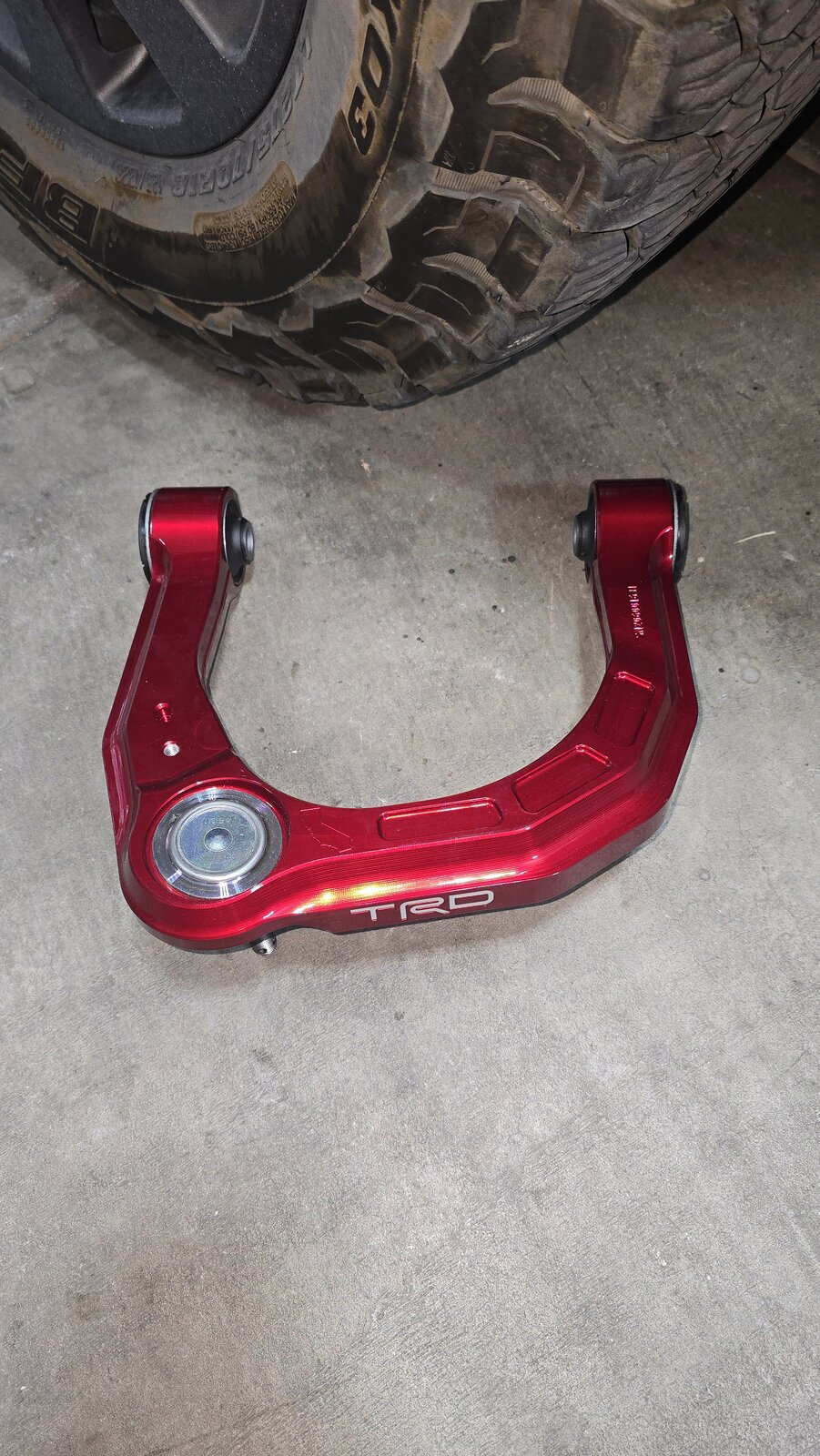

I might as well turn this into the TRD Pro Land Cruiser now, so I'll install the upper arm, maybe find some TRD Pro wheels too.
As of now it will be bumping off the shock shaft bump, like the TRD Pro Taco\4runner.
I'll see if I can make a new bump bracket that will clear the adjuster.
With the OEM shock and 3/8" spacer there was still a little shock travel left at full bump, I think it will be the same with the TRD shock, but will need to verify.

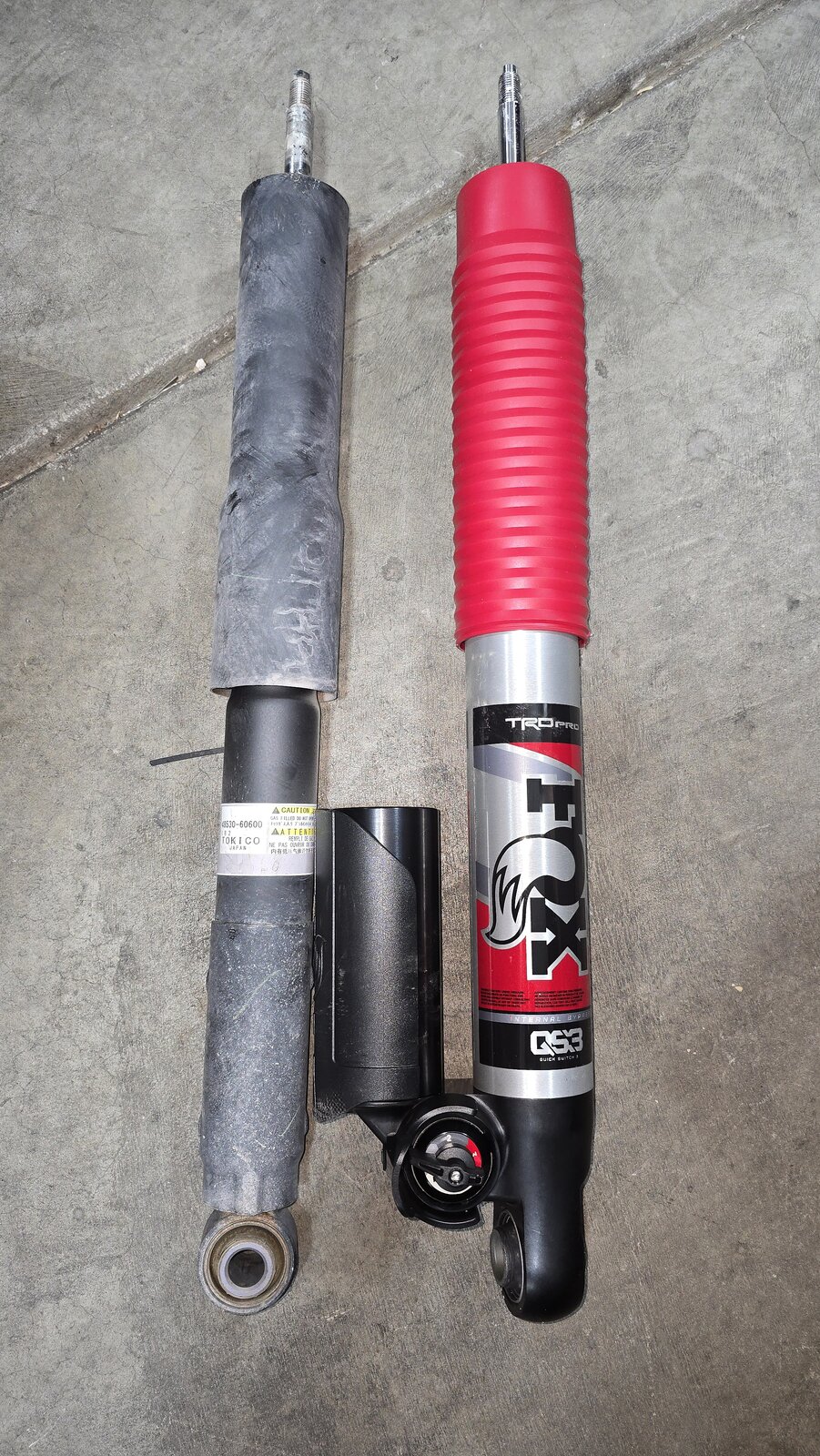

Front Fox shocks PN
PTR61-89250-RF
PTR61-89250-LF
Trd pros don’t have bump stops ? The shocks are strong enough to take all the impact force ?
Yeah, no frame mounted bumps like the LC250, LC 300, GX550, and LX600/700.
Taco and 4runner rely on the shock shaft bump only.
Early taco trd off road models were breaking their upper shock mounts.

These are the part numbers I ordered for the TRD Pro parts:
Front Fox TRD Pro shocks
PTR61-89250-RF
PTR61-89250-LF
Rear Fox TRD Pro shocks
PTR61-89250-RR
PTR61-89250-LR
Front TRD upper arms (still need to check these fit)
48630-0W010
48610-0W010

Front OME\ARB TrailHunter shock (I think this works on the left or right side)
PTR13-89250-FR
Rear OME\ARB TrailHunter shocks
PTR13-89250-RR
PTR13-89250-RL
