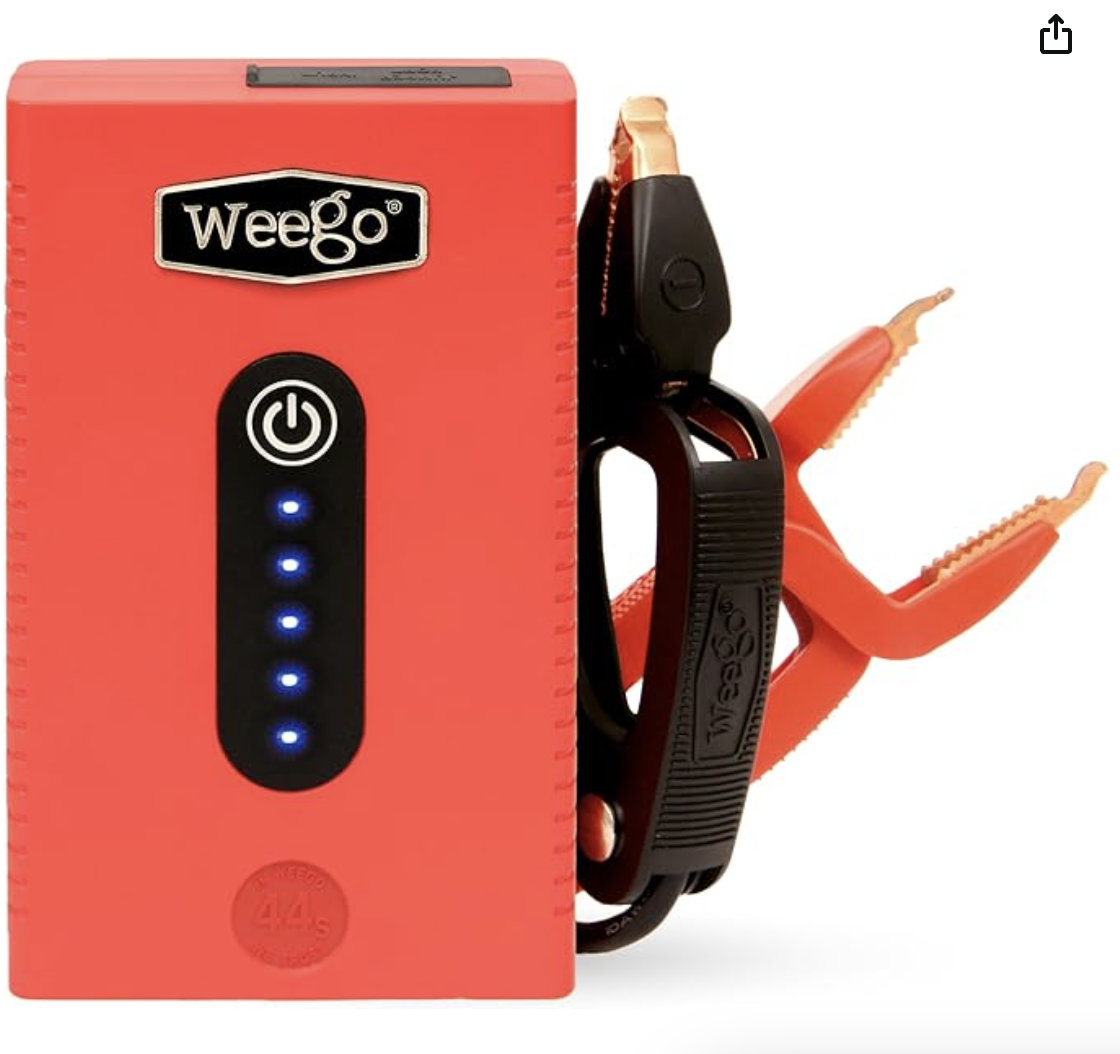

I'm planning to get a jump box to carry with me when I'm off-road. I'm thinking about getting a Weego 44s, a small lithium ion battery pack that would bring the computers online and help get the LC started. Does anyone have any experience with Weego or a similar product?
I could be wrong, but my impression from reading the manual is that you don't need a jump box with high current output so much as just a large battery. I got clamps for the 12V output on my Jackery batteries and I'm hoping leaving one of those plugged in for a little while would be enough to bring the computers online.
Thank you for the recommendation. What do you like about the NOCO vs. Weego? Any personal experience using the NOCO?
I don't have one yet, but that's what I plan to get. They are considered the gold standard in a lot of circles. They have a very good reputation. Check out Project Farm on YT. He tested many jump boxes.
