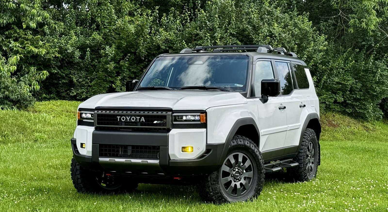

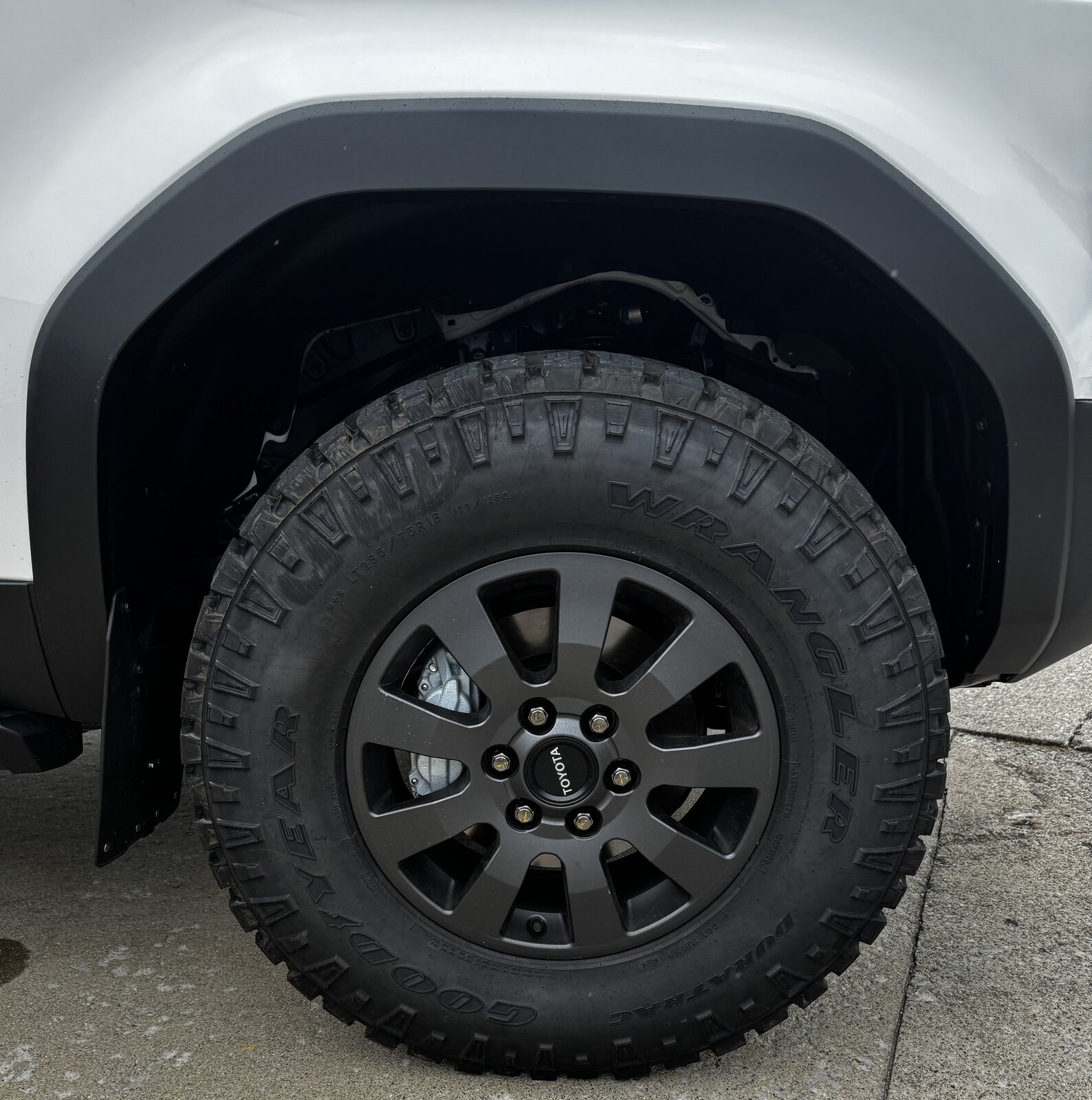

I got the 285/75/r18 work great

Any rubbing at all? And do you level kit upfront?

I have the Wescott “lift” 2” front and either .75 or 1” in back. I forget. No rubbing. I don’t have a ton of extra room but no rubbing- factory wheels. Obviously there are wheels with offset that will help as well.
I see some places that says mine are 34.8” and some say 35.1”. I haven’t measured.

That’s incredible, and you don’t have wheel spacers on your hubs either right?

Nope no spacers. Just the Wescott.
