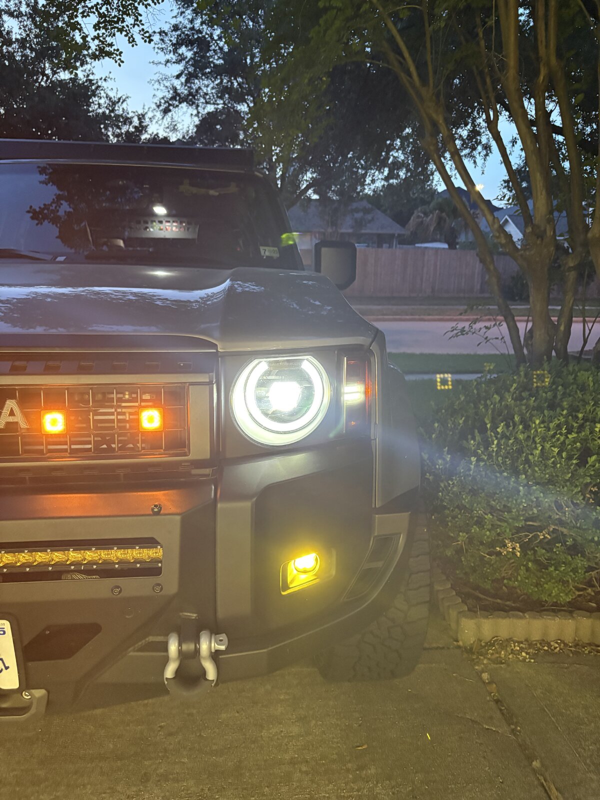

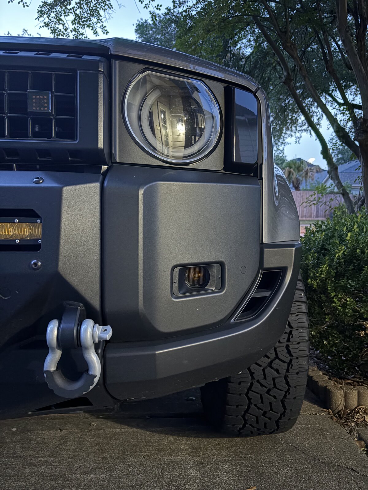

Did you get the yellow or white ones? I am looking at these too.
I just made a post about this, I got the amber… but I agree getting purchase on a couple of those screws isn’t the easiest but I managed with my skeletool. Other than that, it was all pretty easy… also I don’t have to pull anything back, but maybe that’s because of my bumper install? I just laid on my back and looked up lol

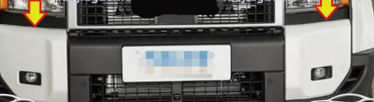

Anyone know if the two bumper guard plates are removeable from the front or does the entire front bumper need to be removed?
The whole front bumper needs to come off to replace the fog lights.
gotcha on fog lights......but if I just wanted to replace a damaged guard plate would it be as easy as removing from front and putting new one in or still need to do a whole bumper removal.
The housings that hold the fogs can only come off with the whole bumper removed. As far as the fogs, I’ve added a winch bumper so my access is different but I’m pretty sure you can figure out a way to get access without removing the whole bumper… but I could be wrong.
Yea if you’re talking about the pieces in the picture, you def have to remove the whole bumper.

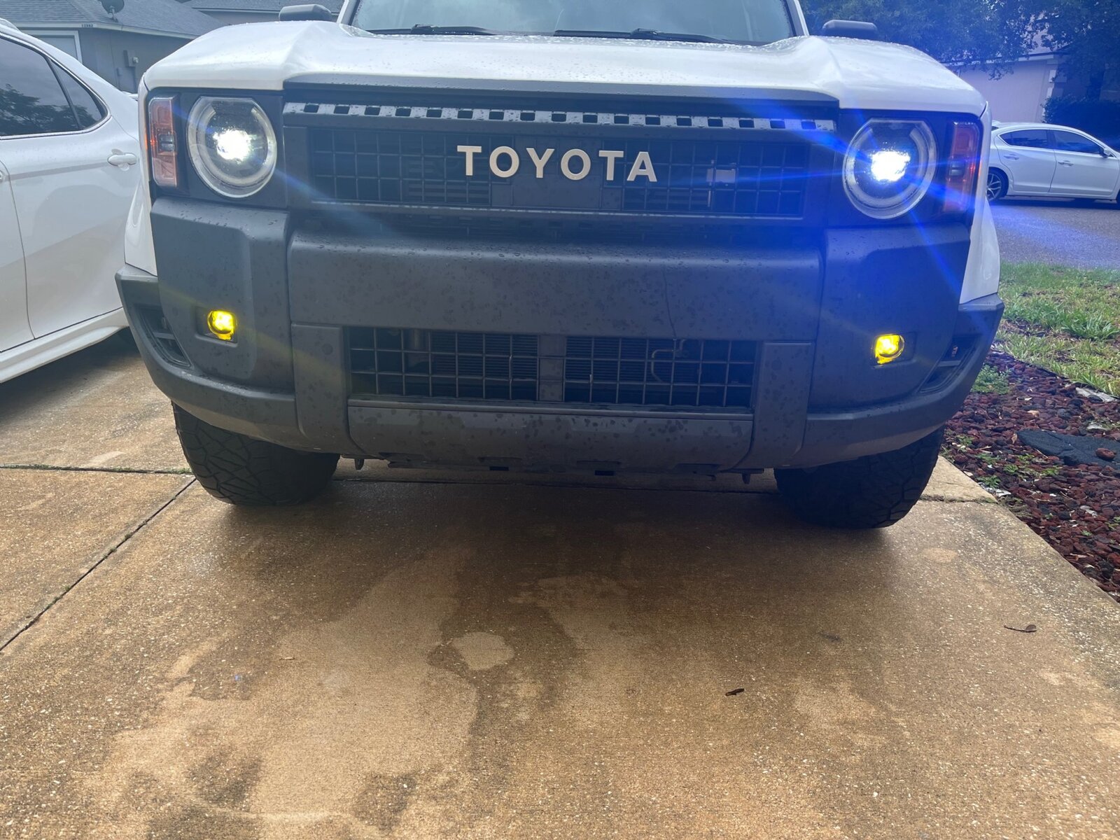

Patience is a virtue. Got a kid from church to stick his arms up inside the bumper. He was able to remove the factory fogs and install the DD fogs. Huzzah!

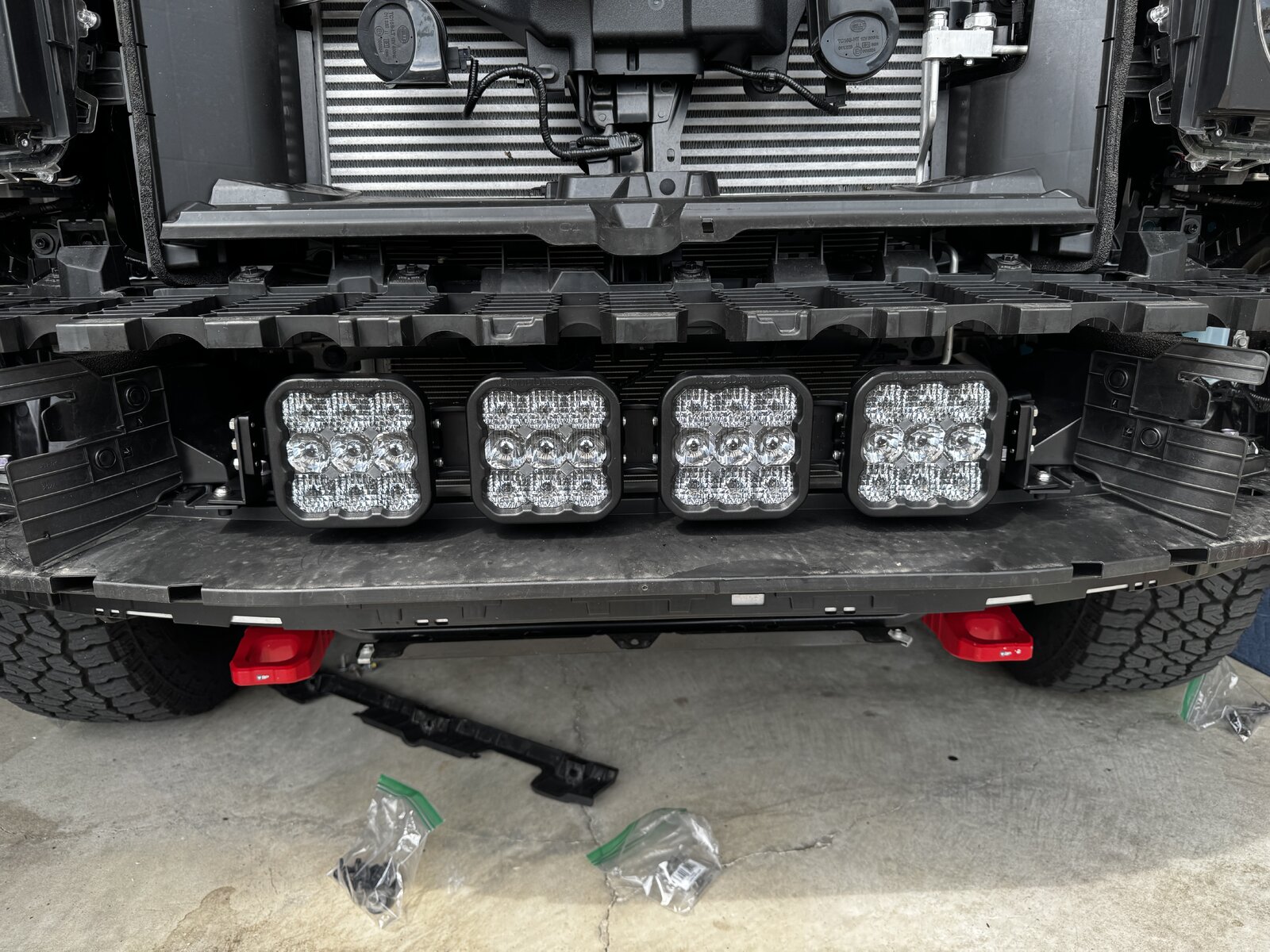

😂 that is one way to do it. I had to take my front off to out the SS5’s in there.
