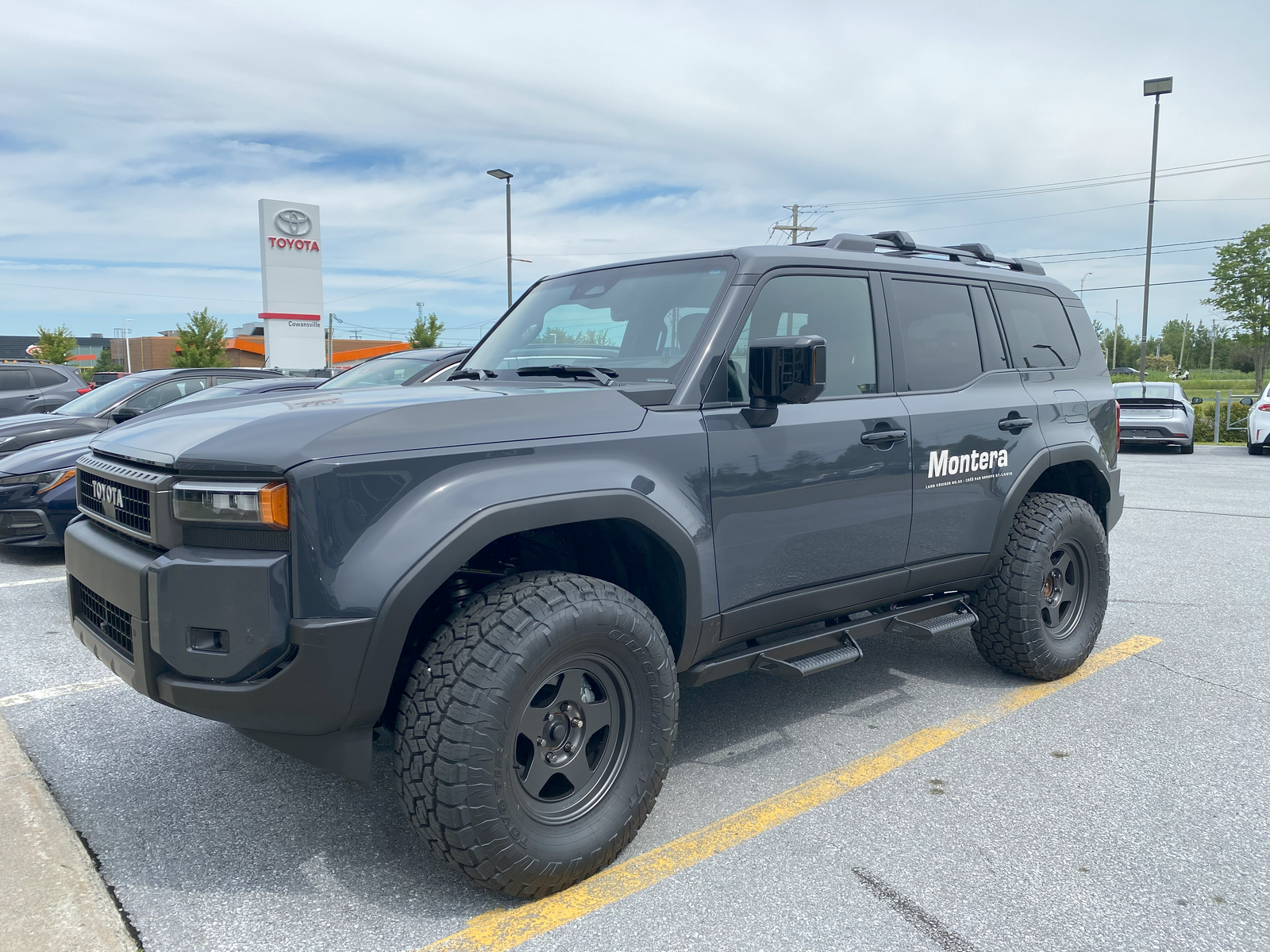

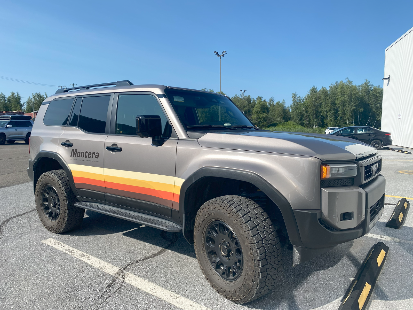

This LC has MT64 with 34s:

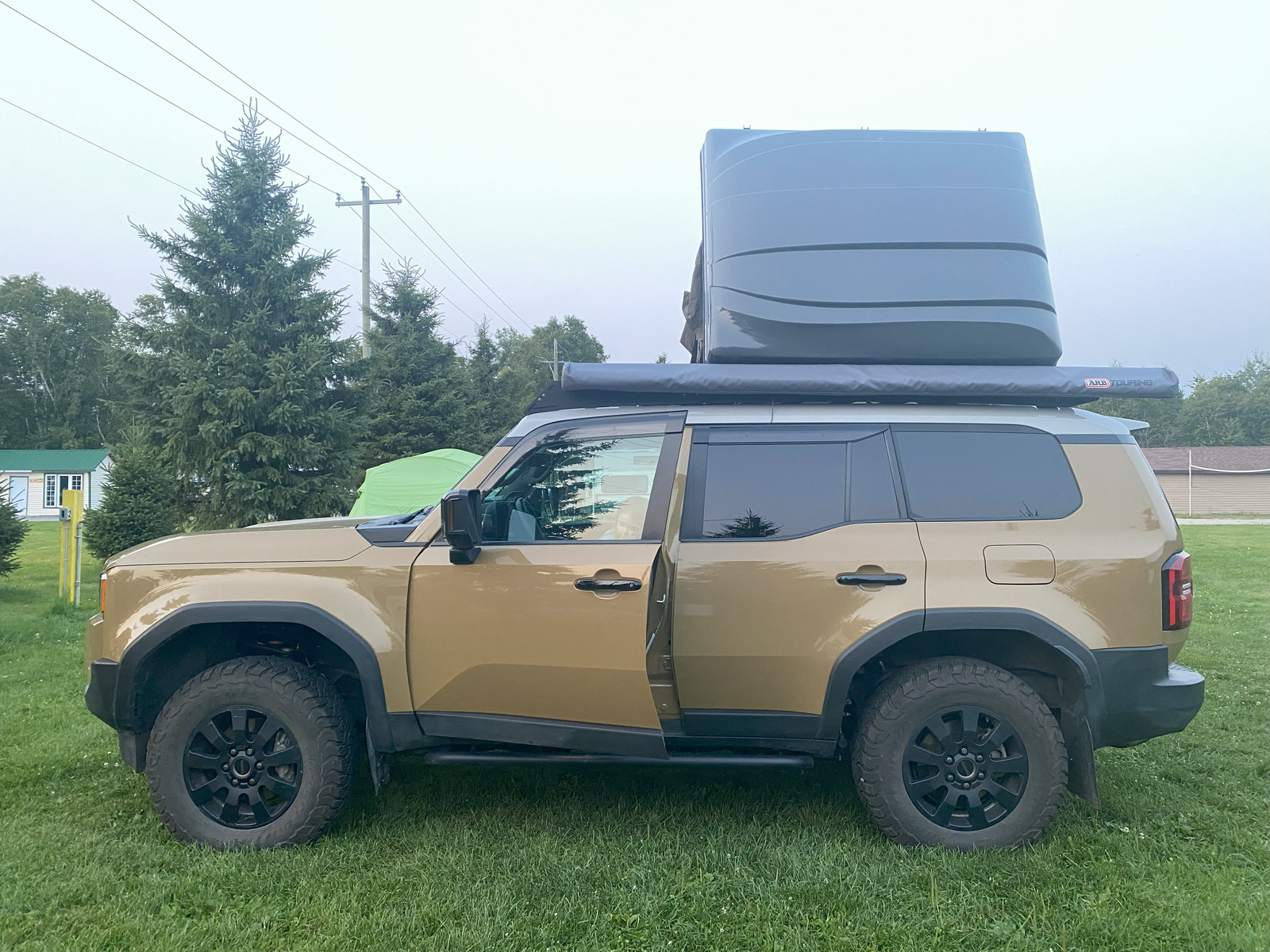

This my mine - I still have KO3 factory size. See how long I can hold off bumping up.... What can I say - I randomly had this installed on my way home. I have a drawer system and RTT, so it's riding a lot nicer. Bumper and winch will level it more how I like it - the shocks are adjustable with rings, too.

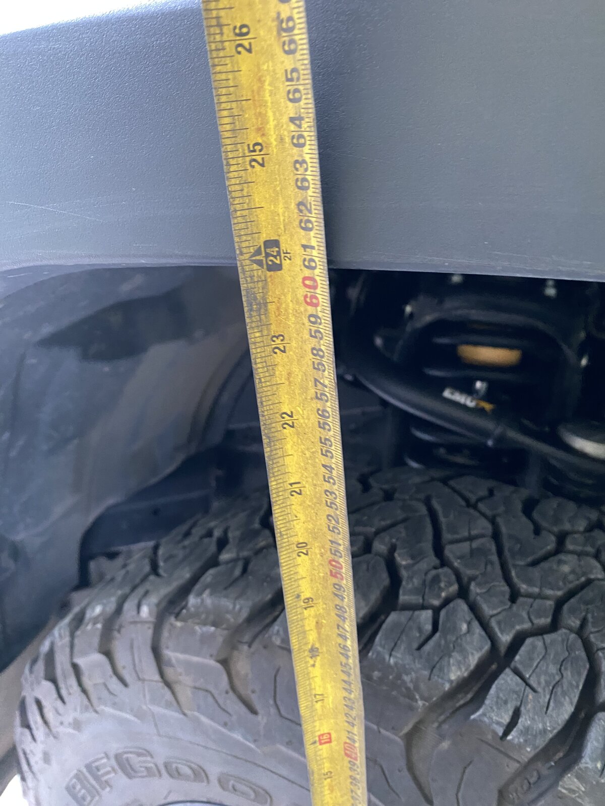

I think on front mine is 1.5” - this is measured from center cap (I compared to a stock LC on dealer lot). I’m still wondering about height, too.
