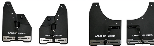

I finished the installation of JAOS Mud Guards III on my LC. Rear guards installation I completed in 15 minutes, using all original fasteners. But it took me at least 2 hours to make a cardboard template for the installation of front guards. Cutting was very easy, but I had to use couple of plastic pop rivets from NAPA to complete the installation.
I really like the look of JAOS flaps and had them on my two previous 4Runners. I found them on Japanese web and they were $290.00 for front and rear sets including shipping.
Looks good. I installed knock off versions from Aliexpress and they bolted right up. What's different about the Jaos on the front ?
