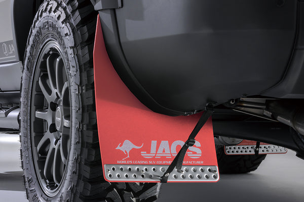

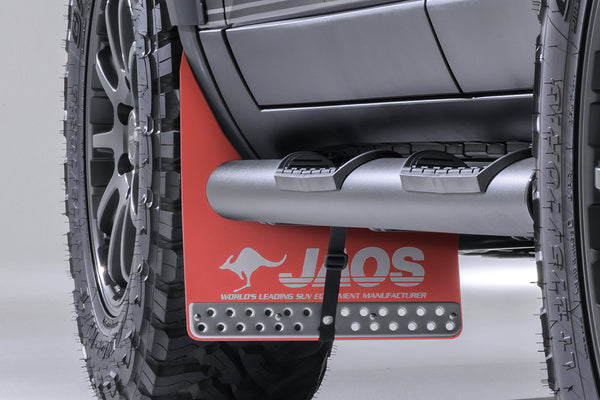

Can you give the link where you bought these from?
Sure, bought them from Black Hawk japan, shipping wasn't bad but that was before the tariff situation.
Rear:
Front:

That does look odd and the marketing pictures don't have that tilt so maybe it's the install? I also see a drill there, I know their fender flares require some drilling but looks like the mud flaps do too?
